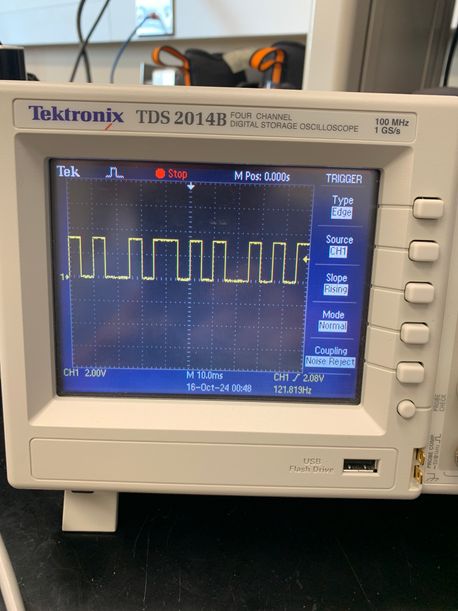

The scope on LD2 shows this.
So I'm getting 5 ms pulses but occasionally it doesn't switch and essentially doubles up. I'm very much still learning all this and dug into the datasheets as much as I could, but at this point I need help from people far smarter than me :) Any help is greatly appreciated!

I'd use 32-bit TIM, will give you more run-way.
Would also not divide down much, as that will give you much finer granularity. You could divide by 8 (PSC=7) and get 1/10 us resolution, 6.5536 ms like scope (at 16-bit)
It randomly doubling on/off doesn't look to be consistent with a wrapping issue.

while((uint16_t)(TIM6->CNT - start) < us);

@Pavel A. I swear I tried this before and it had no effect. Now it is stable at 5 ms.
@PGump.1 This also made it stable at 5 ms.
