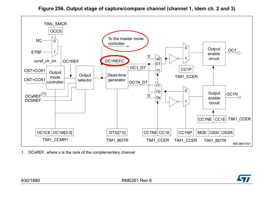

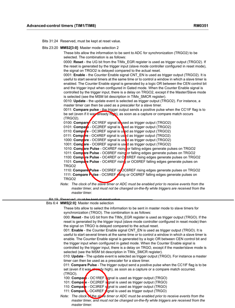

The TIMx_CR2.MMS2/MMS bitr description indicates it's the former (OCxREF) whereas the figure indicates it's the latter (OCxREFC)

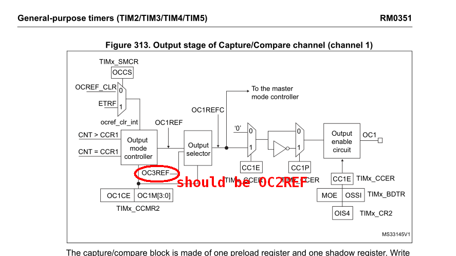

PS. One chapter further, the following picture probably by copy/paste contains incorrect channel nr input to the combiner - it should be OC2REF rather than OC3REF:

​Hello Jan,
I confirm the figure is correct: the signal for TRGO is the combined OCxREFC. The register definition will have to be corrected, as well as the MS33145V1 figure.
Thanks for your feedback.
