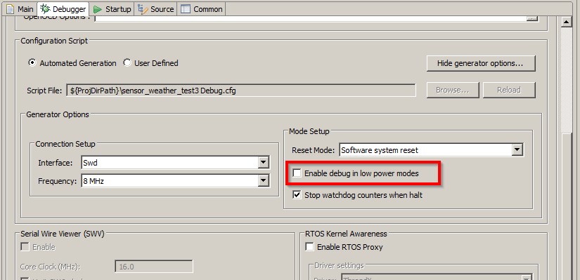

2022-03-19 12:41 PM
I put it aside for couple of days. Now I got back to it.
And it works OK without changing anything. 20 μA in stop mode (LDO + MCU), and 2.6 mA in run mode.
When I flash firmware, disconnect SWD connector, push reset, it consumes 450 μA in stop mode.
I have to completely disconnect power, and connect back power, after that stop mode consumes 20 μA.
Then I found an option in flashing settings "Enable debug in low power modes" which is checked by default. I unchecked it and now it works even after flashing and I do not have to completely disconnect power.

2022-03-19 12:41 PM
