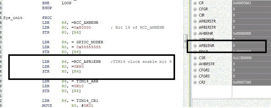

I am now initializing TIM14 following code does not copy to the actual registers at the debugging RCC_APB1ENR EQU 0X4002101C Other registers are showing very correctly but timer 14 related registers should not show the values at the debuggingLDR R6, =RCC_APB1ENR ;TIM14 clock enable bit 8
LDR R0, =0X80
STR R0, [R6] Please see image for better understand
2014-12-12 12:09 PM
I'm not sure what peripherals are present in your particular chip
LDR R0, =0xFFFFFFFF
STR R0, [R6] ; Set all
LDR R0, [R6] ; See which stick
2014-12-12 5:00 PM
LDR R0, =0X11
STR R0, [R6]
But this code is not working
LDR R0, =0X80
STR R0, [R6]
Only code different is
1.
LDR R0, =0X11
2.LDR R0, =0X80
So, I would need second one which is used to enable clock for TIM14 by setting bit 8 of APB1ENRWe’re moving the ST Community to a new platform to give you a better and more reliable community experience.
