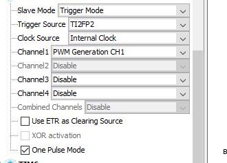

2017-07-27 4:40 AM
2017-07-27 5:18 AM
Thank you Vangelis for taking the trouble to help me and illustrate this with print screens. It's much appreciated!
I'll let you know how it turned out.

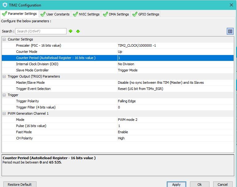

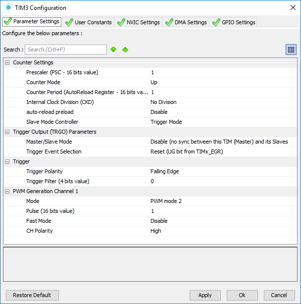

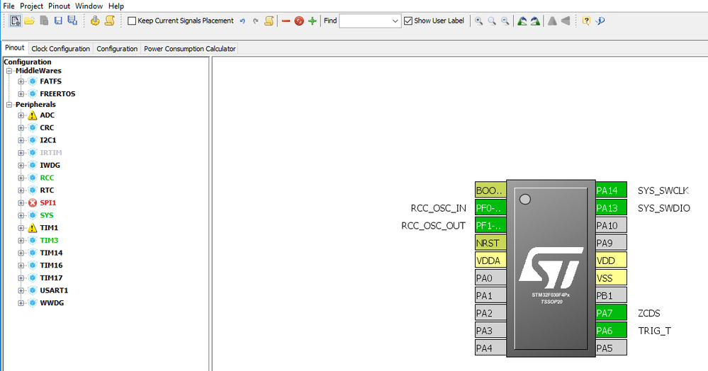

2017-08-17 1:04 AM
Hello Vangelis,
Sorry for the delay. I got pulled away from this due to unavoidable circumstances.
Anyway I tried out the code you so kindly typed out. It didn't work. Instead something strange happened. The ZCD input went high even though i configured everything exactly as you've mentioned. The TRIAC never fires no matter what the value of
SetPhasePercent(value); is set to
. A print screen of my configuration in STM32CubeMX is attached here in. The code's a copy-paste of yours as above. All other settings remain unchanged.Thank you for your help.
