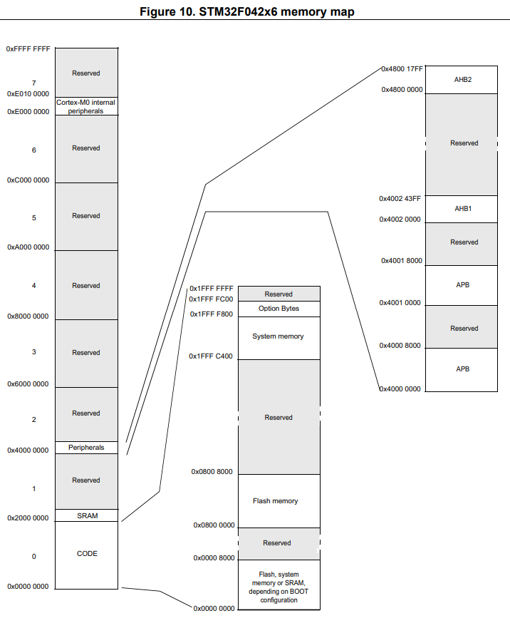

Here is the stm32f042k6 memory model (from datasheet) :
Is there a specific area for user data in flash ?

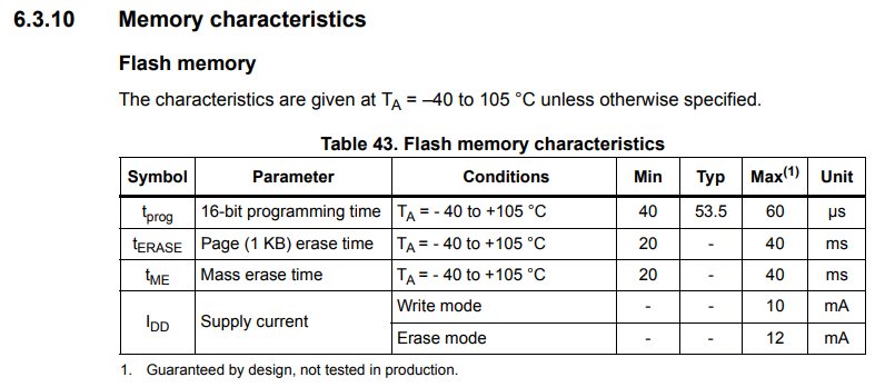

2020-04-01 11:04 AM
Not 1000, but 10000 erase-write cycles.

The flash memory which you can program (erase and rewrite) is the white block from 0x08000000 up to the grey block above it.

Oops, looked at the wrong datasheet.
