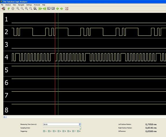

Hello.
I have a problem to cinfigure I2C. This is my code: &sharpdefine PRESC 0x0B &sharpdefine SCLL 0x13 &sharpdefine SCLH 0x0F &sharpdefine SDADEL 0x02 &sharpdefine SCLDEL 0x04 void I2C_PCF_init() { RCC->AHBENR|=RCC_AHBENR_GPIOBEN; GPIOB->MODER|= GPIO_MODER_MODER6_1|GPIO_MODER_MODER7_1; GPIOB->OSPEEDR|=GPIO_OSPEEDER_OSPEEDR6|GPIO_OSPEEDER_OSPEEDR7;//predkosc 50MHZ GPIOB->AFR[0]|=0x11000000; //AF1 RCC->APB1ENR|=RCC_APB1ENR_I2C1EN ; //enable clock for I2C1 I2C1->CR1|=I2C_CR1_PE; //set PE I2C1->CR1&=~I2C_CR1_PE; //reset PE while(I2C1->CR1&I2C_CR1_PE); //while PE ==1 I2C1->TIMINGR|=(PRESC << 28)|(SCLL<<0)|(SCLH<<8)|(SCLDEL<<20)|(SDADEL<<16); //configure for 48Mhz clock I2C1->CR1|=I2C_CR1_PE; //set PE } void I2C_PCF_send(int adress, int lenght) { I2C1->CR2|=(adress<<0)|(lenght<<16)|I2C_CR2_ADD10; //addres SLAVE 10bits I2C1->CR2 &=~ I2C_CR2_RD_WRN; //write I2C1->CR2 |= I2C_CR2_START; I2C1->TXDR=0xff; while(I2C1->ISR&I2C_ISR_TXIS); //wait for TXDR will be empty and data was send. I2C1->CR2|=I2C_CR2_STOP; } No matter what i write after this part: I2C1->CR2 |= I2C_CR2_START; I2C sending data like this:2013-12-19 2:30 AM

I think I2C1->CR2|=(adress<<0)|(lenght<<16)|I2C_CR2_ADD10; //addres SLAVE 10bits I2C1->CR2 &=~ I2C_CR2_RD_WRN; //write I2C1->CR2 |= I2C_CR2_START; Tells the I2C controller to send the start bit and the device address. BUT then you immediately do I2C1->TXDR=0xff; Then try to wait for the data to be transmitted. while(I2C1->ISR&I2C_ISR_TXIS); You need to wait for the start bit and the device address to complete before trying to send the data. You need to add another ''while(I2C1->ISR&I2C_ISR_TXIS);'' or something before the ''I2C1->TXDR=0xff;'' Some points to consider : 1. READ THE MANUAL/DATA SHEET! Understand the I2C controller. 2. The while loops do not have any timeout/escape conditions - your program could get stuck at the while loops.2013-12-19 10:28 AM

The problem was here: I2C1->CR2|=(adress<<0)|(lenght<<16)|I2C_CR2_ADD10; //address SLAVE 10bits I was try to send 8 bits address, but that was send only 2 MSBs on 10bits mode, and slave dont send ACK, so master try to send again that 2 bits. This is working ''write'' code: void I2C_PCF_send(int address, int length) { while ((I2C1->ISR & I2C_ISR_TXE)==0); //while TXE ==0, buffer is full I2C1->CR2|=(address<<0)|(length<<16)| I2C_CR2_AUTOEND ; //address SLAVE 7bits I2C1->CR2 &=~ I2C_CR2_RD_WRN; //write I2C1->CR2 |= I2C_CR2_START; while ((I2C1->ISR & I2C_ISR_TXE)==0); //while TXE ==0, buffer is full I2C1->TXDR=0xff; }We’re moving the ST Community to a new platform to give you a better and more reliable community experience.
