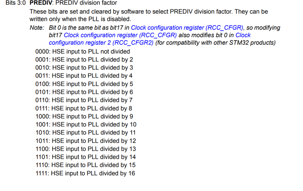

The mistake was in line 44 and 43. I removed the CFGR 2 line and added the following to line 44 | RCC_CFGR_PLLXTPRE_HSE_PREDIV_DIV2. That was my main issue.
I also had another little mistake in the last while loop of the RCC Init but that was not the issue.
I was setting CFGR2 as the pre div inas seen below, as it says it is the same as CFGR, however when I set CFGR1 instead and removed the statement of CFGR2 it all worked well. A bit confusing but figured it out now thanks to your help.
Edit: On second thought I had tried the PLLXTPRE thing before and it didin't work so I think it was the change in definition and putting PLLXTPRE in again together
