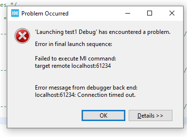

I am using the STM32F746 board and trying to program the microcontroller. However, the STM32Cube IDE software is showing an error, as shown in the figure. The "stlink_USB" and "5V" are connected.

We need a lot more information. What version of CubeIDE (don't say "the latest")? What board are you using - a Nucleo board? You own custom board? What STLink are you using - the one on the Nucleo board? A stand-alone STLink? If stand-alone, provide a picture of it.
You say "stlink_usb" and 5V are connected - is you board powered from an external 5V supply?

I am using version 1.15.0 of STM32CubeIDE. I have an STM32F746 Discovery Kit with an integrated STLink. I power the board via the USB-STLink cable connected to the computer. We have also tried to program the board with three different computers

Having the full gdb log might help.
Does you code re-configure the JTAG/SWD pins?
Try loading a trivial program like Blinky (just flashes an LED).
Try programming with stand-along CubeProgrammer.
