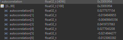

I instead get very off numbers:
I am very stuck on this, so if anyone has any sort of insight as to why the cmsis library is not producing similar results I would appreciate. I am thinking I might have to do more conditioning to the input to the ifft due to some differences, but what that is I am not sure. I pretty much only have a basic understanding of how these functions work.
