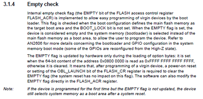

Yes if the device il "empty" the bootloader will start always (if the BOOT_LOCK bit is not set) see 3.1.4 in RM0490:
So You should have the possibility to enter the bootloader for the 1. download of Your application, then your application has to set the nBOOT_SEL to 0, so You have legacy access to the bootloader via BOOT0.

They where already programmed before they got potted in. So I was hoping that somehow via a hack (some flashes erase on high voltage for example, or maybe there is some SWCLK magic, I don't know...) I could erase the existing application and/or execute the bootloader anyway.
2024-10-03 5:21 AM
If the SWD pins are not available, and the option bytes are at default, and a program is in flash, there is no way to get back into the bootloader.
