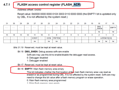

2025-08-06 7:17 AM
Hi, I just found out a supper simple way, just one line of code, I am not sure if it work on your processor but it works on mine.
Set this flag to 1, and trigger a reset,
