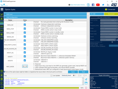

if I understand to your problem right, you want to use Pin 4 on SO8N package as PA0. So you should configure pin PA0 in standard way and disable reset pin PF2-NRST which is enabled by default. The easiest way how to do it is to download STM32CubeProgrammer STM32CubeProg - STM32CubeProgrammer software for all STM32 - STMicroelectronics and disable reset pin there.
Open STM32CubeProgrammer connect your MCU to computer through ST-LINK, UART or USB and press green Connect button. Than go to Option bytes and select User Configuration, there configure NRST_MODE as 2 which disables reset pin. At the end press Apply to download this update to MCU.
If you configure PF2-NRST pin like this, reset will be enabled only immediately after MCU power is turned on and than reset will be disabled and you can use this pin as standard GPIO. Due to there shouldn´t be connected low logic level signal to Pin 4 when the power of MCU is turned on. If there will be connected low logic level MCU still in reset state.
