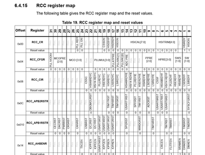

2024-04-27 5:30 AM
Good.
To see, what its doing, look at rm , RCC registers:
If using HSI at 48M , is same clock, but precision on crystal->HSE->PLL is better . If not needed, can use HSI also.
