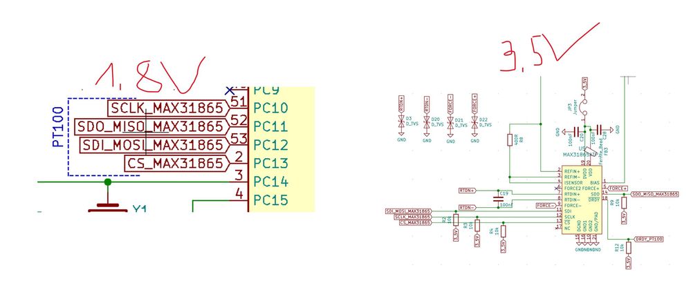

I have an 1.8V STM32 and an 3.5V MAX31865 which are connected via SPI, I used 10k Ohms pullups on data line to 3.5V. Now the problem is that communication dosen't work. When I increas STM32 voltage to 3.5 V everything is fine. Is there an limitation in logic high on STM32 side?

I tried 1k 10k and 100k as clock rate, but all these combinations didn't work. If I lower the difference between STM32 and MAX31865 to 1.5V it works fine.

Are you driving SCK and MOSI as Open-Drain?
2021-02-03 4:18 AM
No, they are driven as push/pull. Does this cause problems?
2021-02-03 4:21 AM
I use push-pull configuration.
2021-02-03 4:40 AM
Of course, the pull up transistor to 1.8. Volt will win against the pull up to 3.5. Volt and so SCK/MOSI will not reach a level that the device will recognize as high.
2021-02-03 4:58 AM
OK, thanks. Open drain than should actually be possible?
