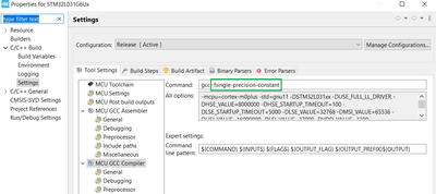

Interesting that the compiler automatically assumes double floating point calculations, these "__aeabi_dxxx" libs take some more space.
I found that I can suppress this with adding "-fsingle-precision-constant" to gcc in the compiler settings:
Gave me 4 kB flash back.
Is that the correct way? Feels somehow not so elegant...
2024-09-26 2:55 AM
@LCE wrote:Interesting that the compiler automatically assumes double floating point calculations,
Indeed:
https://mcuoneclipse.com/2019/03/29/be-aware-floating-point-operations-on-arm-cortex-m4f/
