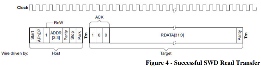

>How can I switch spi to receive 3 bit with the ack?
Receive 4 bits including the turn-around bit

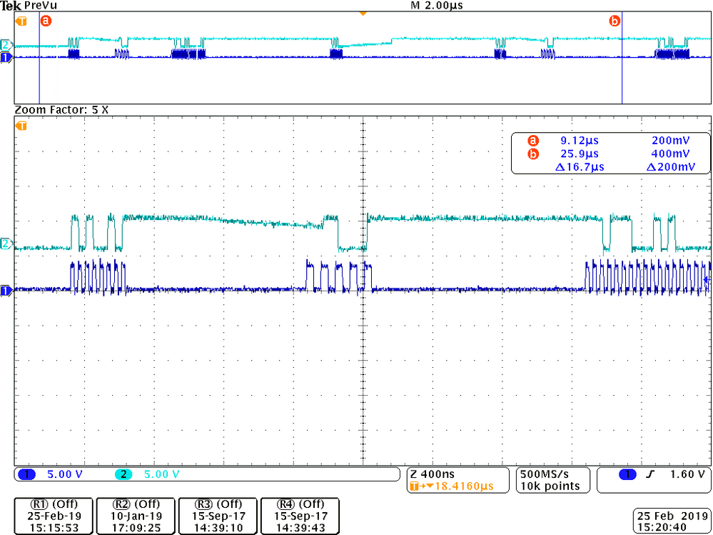

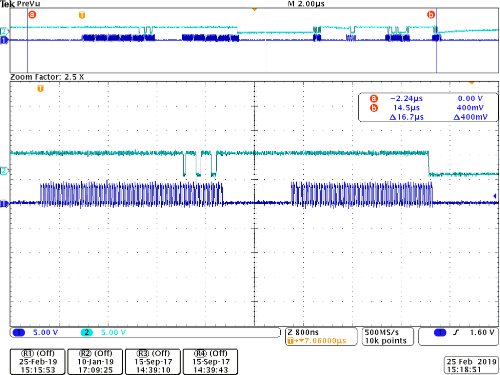

You can do swd with spi if you use spi with fifo and variable bit size. At least no need to manipulate the gpio except disabling mosi when reading back data. No bitbang needed. The tricm is to group the turnaround bits and see 5 bit when you see 3 and slice the 32 bit with parity in something like 8 8 9 bits.
2019-12-06 11:20 AM
Here some code extract to give you directions:
I used this link to get baseline: https://www.cnblogs.com/shangdawei/p/4753040.html
You will short MISO and MOSI outside. Here is STM32L4R5 in BGA132 @ 48MHz SYSCLK (low power) with 12 MHz SPI

// now let's look at the generated signals...

Then you get something like this:
void SWD_Read(uint8_t cmd, uint32_t* pdata32) {
uint32_t readback;
uint8_t Regs[7];
SWD_WaitIdle();
FlushRxFifo();
*(__IO uint8_t *)&SPI3->DR = cmd; // CMD transmit 8 bit
SWD_WaitIdle();
SWD_RxMode();
SWD_SetSPICR1Slower();
SWD_SetBits(5);
*(__IO uint8_t *)&SPI3->DR = 0x99; // move 5 bits
SWD_WaitIdle();
readback = *((__IO uint16_t *)&SPI3->DR); // read past 8 + 5 bit
SWD_SetSPICR1Normal();
SWD_SetBits(8);
Regs[0] = readback & 0xFF;
readback >>= 8;
Regs[1] = readback;
SWD.Ack = (readback & 0x0E)>>1;
SWD.du32 = (readback & 0x10)>>4;
SWD.bitsum = SWD.du32;
if(SWD.Ack!=0x01) { // NOK
// error and abort
SWD_TxMode();
return;
// OK, so now we read the leftover bits (lsb is captured already)
*(__IO uint8_t *)&SPI3->DR = 0x99; // move 8 bit LSB
*(__IO uint8_t *)&SPI3->DR = 0x99; // move 8 not
SWD_WaitIdle();
Regs[2] = *((__IO uint8_t *)&SPI3->DR);
Regs[3] = *((__IO uint8_t *)&SPI3->DR);
Regs[4] = *((__IO uint8_t *)&SPI3->DR);
SWD_SetBits(9);
*(__IO uint16_t *)&SPI3->DR = 0x9999; // move 8+1 bits
SWD.temp32 = Regs[2];
SWD.du32 |= (SWD.temp32<<1);
SWD.bitsum ^= NibbleBitCounter[(SWD.temp32>>0) & 0x0F];
SWD.bitsum ^= NibbleBitCounter[(SWD.temp32>>4) & 0x0F];
SWD.temp32 = Regs[3];
SWD.du32 |= (SWD.temp32<<9);
SWD.temp32 = Regs[4];
SWD.du32 |= (SWD.temp32<<17);
SWD_WaitIdle();
Regs[5] = *((__IO uint8_t *)&SPI3->DR);
Regs[6] = *((__IO uint8_t *)&SPI3->DR); // turnaround bit included
SWD_SetBits(8);
SWD_TxMode();
// we rebuild all decoded values
SWD.temp32 = Regs[5];
SWD.du32 |= ((SWD.temp32&0x7F)<<25);
SWD.bitsum ^= NibbleBitCounter[(SWD.temp32>>4) & 0x0F]; // includes parity bit
SWD.parity = (SWD.temp32 & 0x80)>>7;// optional
// calculate the parity bit
//if((SWD.bitsum)/*||(SWD.du32!=0x2BA01477)*/)
// NOPs(1);
*pdata32 = SWD.du32;

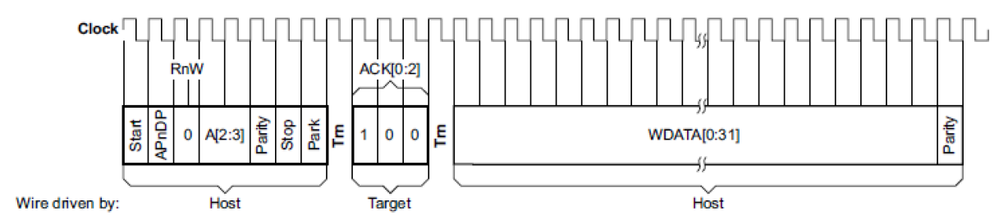

void SWD_Write(uint8_t cmd, uint32_t data32) {
uint32_t readback;
SWD_WaitIdle();
FlushRxFifo();
*(__IO uint8_t *)&SPI3->DR = cmd; // Transmit CMD 8 bit
SWD_WaitIdle();
SWD_RxMode();
SWD_SetBits(5);
*(__IO uint8_t *)&SPI3->DR = 0x99; // send 5 bits = Tn ACK Tn
SWD_WaitIdle();
readback = *((__IO uint16_t *)&SPI3->DR); // read the answer
SWD_SetBits(8);
SWD_TxMode();
// SWD.Regs[0] = readback & 0xFF;
// SWD.Regs[1] = readback >> 8;
SWD.Ack = (readback >>9) & 0x07;
NOPs(1);
// error and abort
return;
*(__IO uint8_t *)&SPI3->DR = (data32 >>0) & 0xFF; // send 8 bit (hopefully)
*(__IO uint8_t *)&SPI3->DR = (data32 >>8) & 0xFF; // send 8 bit (hopefully)
*(__IO uint8_t *)&SPI3->DR = (data32 >>16) & 0xFF; // send 8 bit (hopefully)
// Here we prepare the data to transmit Regs[2..3..4..5]
// LSB to MSB
SWD.temp32 = data32;//SWD.Regs[2] | (SWD.Regs[3]<<8) | (SWD.Regs[4]<<16) | (SWD.Regs[5]<<24);
SWD.bitsum = NibbleBitCounter[(data32>>0) & 0x0F];
SWD.bitsum ^= NibbleBitCounter[(data32>>4) & 0x0F];
SWD.bitsum ^= NibbleBitCounter[(data32>>8) & 0x0F];
SWD.bitsum ^= NibbleBitCounter[(data32>>12) & 0x0F];
SWD.bitsum ^= NibbleBitCounter[(data32>>16) & 0x0F];
SWD.bitsum ^= NibbleBitCounter[(data32>>20) & 0x0F];
SWD.bitsum ^= NibbleBitCounter[(data32>>24) & 0x0F];
SWD.bitsum ^= NibbleBitCounter[(data32>>28) & 0x0F];
SWD.parity = SWD.bitsum;
SWD.temp32 = ((data32 >>24) & 0xFF ) |((SWD.bitsum & 0x01)<<8); // parity bit
SWD_WaitIdle();
SWD_SetBits(9);
*(__IO uint16_t *)&SPI3->DR = SWD.temp32; // send 9 bit (hopefully)
SWD_WaitIdle();
FlushRxFifo();
SWD_SetBits(8);
}This is a fun experiment, you can start/stop/reset the core, read/write internal RAM.

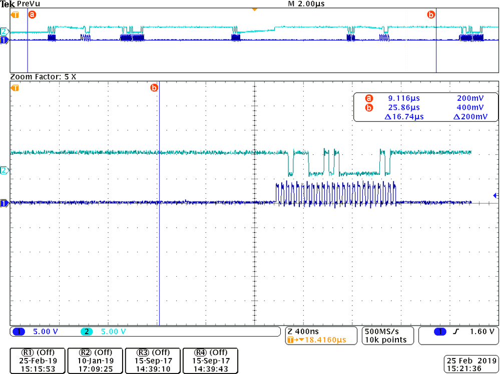

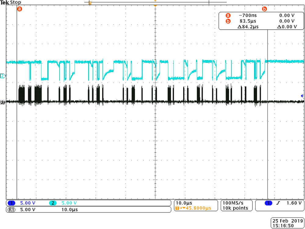

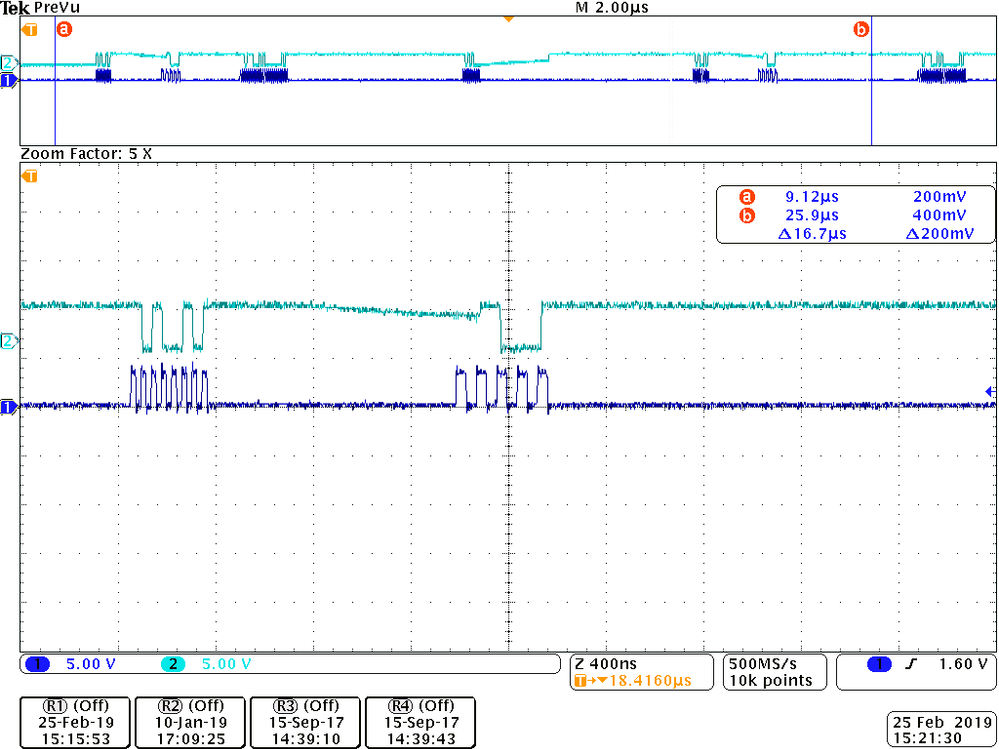

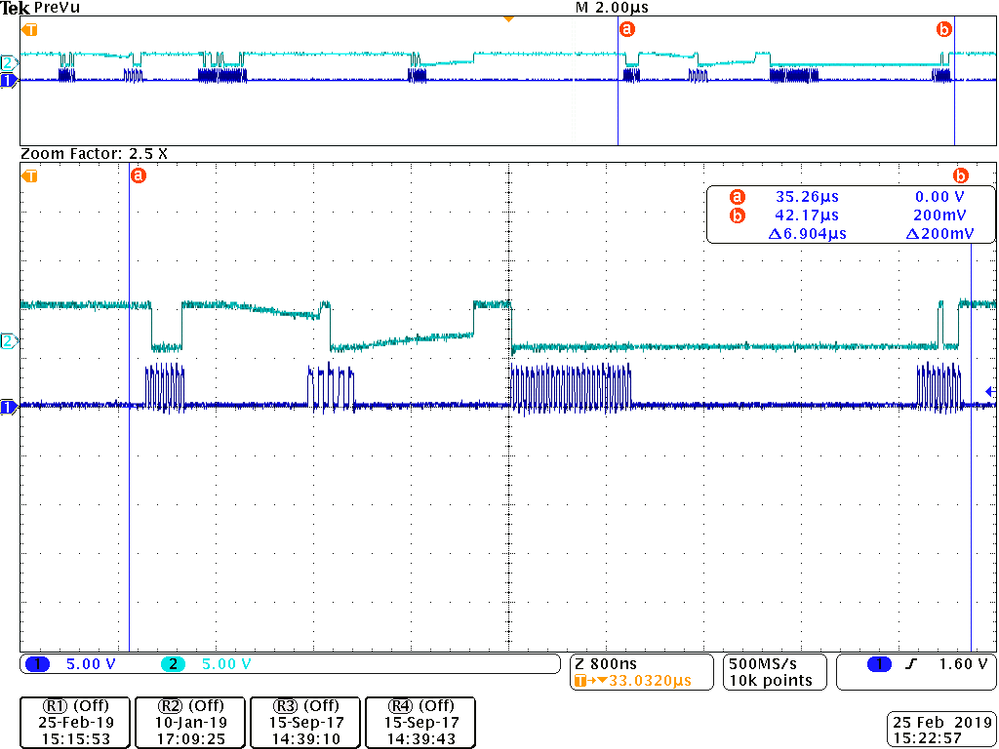

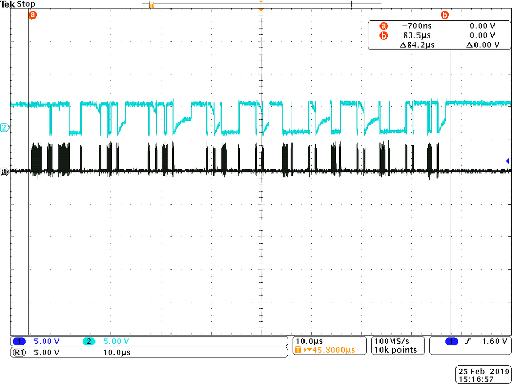

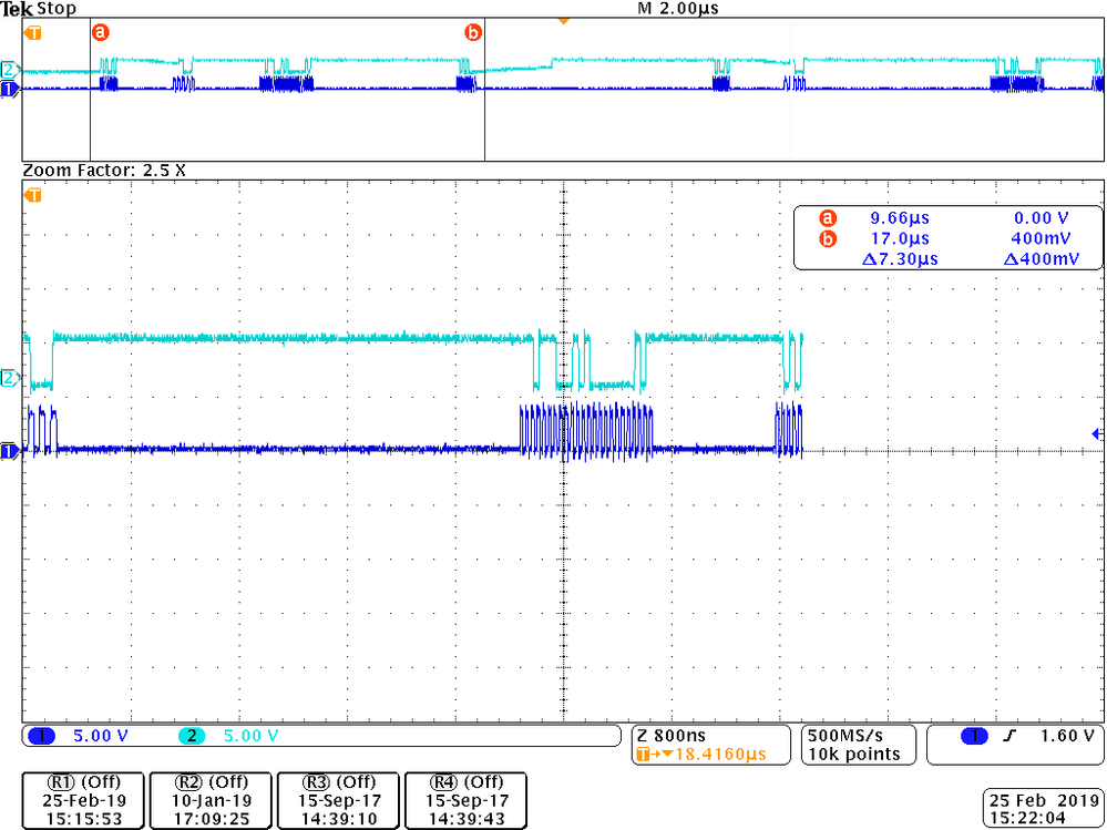

2019-12-06 11:37 AM
Some pictures
So to have a even fast communication, the SPI should have a special mode where the data register is split in MSB = bit length with R/W, LSB = data bits
Then the delay between packets could be minimized and average speed improved further. A true 3 wire interface would save 1 GPIO unless voltage shifting required outside.
