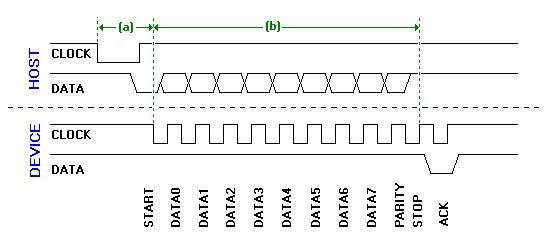

2013-02-20 7:17 AM
Doesn't look compatible with any STM32 peripheral.
Bit bang, use Google?http://hackaday.com/2010/11/08/czech-discovery-ressurects-ps2-keyboard/
