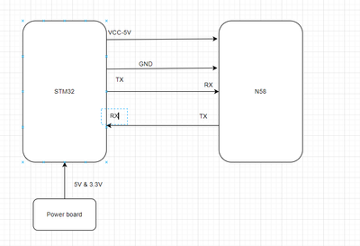

2. About schematic:
I know I am sorry for the inconvenience I will check with my team what things can I share in the forum.
3.
Do the boards share a common ground?
Do the Output signals on one board go to the Input on the other?
STM32 supplies 5v supply and ground to the N58 board.
Another thing you haven't said is what debugger you're using.
Does it supply power to the board?
Debugger I am using is Segger Jlink debugger.I only connected SWD lines and ground to PC.VCC line I didn't connected to the STM32 and debugger.
