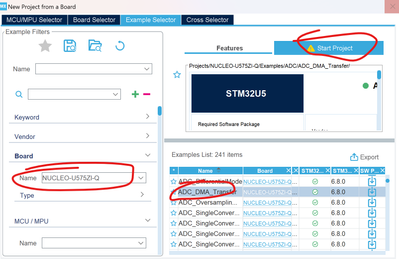

Starting with the example in full, before moving to something else. You need all the files to be correct/consistent, not just main.c.
The Example Selector in STM32CubeIDE can be used to load this example.
In this case you haven't modified your main.h file to include those definitions.

2025-02-16 1:04 PM

Good morning,
Thank you for the fast reply.
I uninstalled and reinstalled the STM32CubeIDE and followed your steps and now at least the project can be built.
Can I do something else apart from building it? Of course it is not going to work as i have different nucleo but if i try to "copy/follow" the same procedures in a new project with my nucleo should work right?
Thank you
