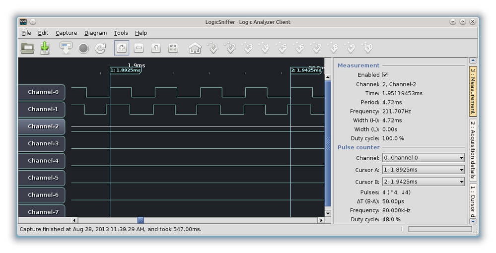

I set an interruption handler for a timer. Each time it calls the handler I change the state of a IO. But I'm getting problems for frequency above 80kHz. If I set the period to:TIM_TimeBaseStructure.
TIM_Period
= SystemCoreClock/160000
-1
; I got an 80kHz in the channel output and in the IO that is changed by the interruption: Channel-0: PA2 - Timer 2 Chanel 2 Channel-1: PC9 - IOTIM_TimeBaseStructure.
TIM_Period
-1
;It will create a 85kHz on OC2 but the IO drive by the interruption can't handle it. Am I in the limit of normal io speed? The measured frequency for the IO is 42kHz.

Interrupting the processor at several hundred KHz, is probably getting close to saturating a 24 MHz processor. Limited by the number of instructions per interrupt.
You'd definitely want to change your interrupt so it doesn't re-enter (M3/NVIC pipeline hazard), by doing the clearing early.void TIM2_IRQHandler(void)
TIM_ClearITPendingBit(TIM2,TIM_IT_Update);
change=1;
