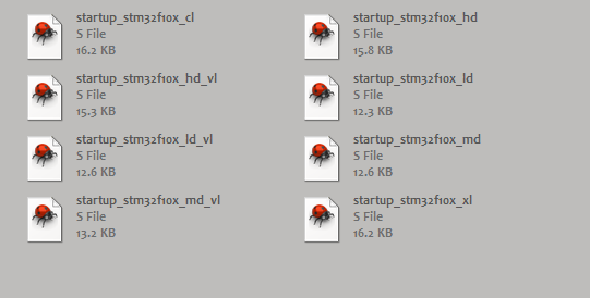

i have Problems in choosing startup from StdPeriph_Lib my MCU is STM32f103vct6
Which should I use and why?

Google STM32F103VC, it's a High-Density part
http://www.st.com/en/microcontrollers/stm32f103vc.html
startup_stm32f10x_hd.s

What's hd_vl ?

Here ST's explanation from their
stm32f10x.h
file (guess it causes the post to go into moderation, too):/* ♯ define STM32F10X_LD */ /*!< STM32F10X_LD: STM32 Low density devices */
/* ♯ define STM32F10X_LD_VL */ /*!< STM32F10X_LD_VL: STM32 Low density Value Line devices */
/* ♯ define STM32F10X_MD */ /*!< STM32F10X_MD: STM32 Medium density devices */
/* ♯ define STM32F10X_MD_VL */ /*!< STM32F10X_MD_VL: STM32 Medium density Value Line devices */
/* ♯ define STM32F10X_HD */ /*!< STM32F10X_HD: STM32 High density devices */
/* ♯ define STM32F10X_HD_VL */ /*!< STM32F10X_HD_VL: STM32 High density value line devices */
/* ♯ define STM32F10X_XL */ /*!< STM32F10X_XL: STM32 XL-density devices */
/* ♯ define STM32F10X_CL */ /*!< STM32F10X_CL: STM32 Connectivity line devices */
/* Tip: To avoid modifying this file each time you need to switch between these
devices, you can define the device in your toolchain compiler preprocessor.
- Low-density devices are STM32F101xx, STM32F102xx and STM32F103xx microcontrollers
where the Flash memory density ranges between 16 and 32 Kbytes.
- Low-density value line devices are STM32F100xx microcontrollers where the Flash
- Medium-density devices are STM32F101xx, STM32F102xx and STM32F103xx microcontrollers
where the Flash memory density ranges between 64 and 128 Kbytes.
- Medium-density value line devices are STM32F100xx microcontrollers where the
- High-density devices are STM32F101xx and STM32F103xx microcontrollers where
the Flash memory density ranges between 256 and 512 Kbytes.
- High-density value line devices are STM32F100xx microcontrollers where the
- XL-density devices are STM32F101xx and STM32F103xx microcontrollers where
the Flash memory density ranges between 512 and 1024 Kbytes.
- Connectivity line devices are STM32F105xx and STM32F107xx microcontrollers.

vl stands for Value Line, which are the F100 only.
