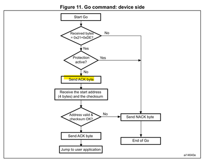

2024-07-09 4:45 PM - edited 2024-07-09 4:46 PM
That particular ACK acknowledges protection is not active and the host can send the address. It's not a bug. It's in the UART protocol document here:
Multiple ACKs can be and often are within the same command.
cd00264342-usart-protocol-used-in-the-stm32-bootloader-stmicroelectronics.pdf
