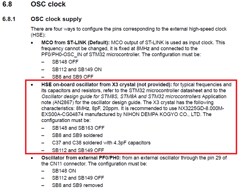

I use STM32 NUCLEO-F746ZG development board for my project. I split the ST-LINK and target STM32 part (Cut PCB). I tried to use HSE on-board oscillator from X3 crystal. I soldered the NX3225GD-8.000MEXS00ACG04874 8-MHz crystal oscillator and two 4.7 pF capacitors according the manual. Also, I applied the other configuration steps which stated at UM1974 (User Manual) 6.8.1 OSC clock supply section. However, I haven’t seen 8 MHz oscillator signal from oscillator probe when I tested. Due to lack of oscillator signal, the program in the flash memory does not execute.
Is there any additional steps to apply in order to use HSE on-board oscillator from X3 crystal?
Are you sure? The label says F429ZI.
2020-03-31 1:24 AM
Oops. Sorry. The picture is from STM32F429ZI. I will remove it. I apply the same config for this board also. According to manual HSE on-board oscillator from X3 crystal configuration is same for both STM32F429ZI and STM746ZG
