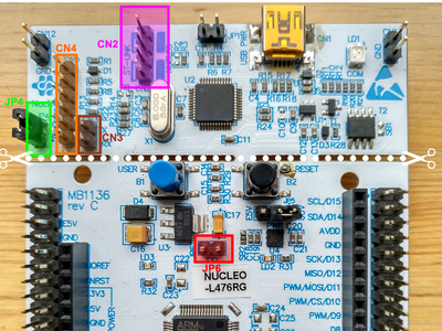

Any Nucleo 1. cut upper debuger and on your board only CN counterpart required.
BOOT0 isnt used with SWD, but what other tools do I need to make the USB programming possible = CubeProgrammer sw
