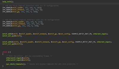

I'm attempting to bind multiple IP addresses to a single Ethernet port using different struct netif logical interfaces. My current implementation does not works for the both IP addresses
Seeking guidance or resources on the correct approach. Any insights appreciated.

2024-02-06 1:52 AM
Both are not working,
but one works if you deactivate one of them:
//ethernetif_input(&netif);
ethernetif_input(&netif_0);
IP4_ADDR(&netif_ipaddr, configIP_ADDR0, configIP_ADDR1, configIP_ADDR2, configIP_ADDR3);
IP4_ADDR(&netif_netmask, configNET_MASK0, configNET_MASK1, configNET_MASK2, configNET_MASK3);
IP4_ADDR(&netif_gw, configGW_ADDR0, configGW_ADDR1, configGW_ADDR2, configGW_ADDR3);
IP4_ADDR(&netif_ipaddr_0, configIP_ADDR0_0, configIP_ADDR1_0, configIP_ADDR2_0, configIP_ADDR3_0);
IP4_ADDR(&netif_netmask_0, configNET_MASK0_0, configNET_MASK1_0, configNET_MASK2_0, configNET_MASK3_0);
IP4_ADDR(&netif_gw_0, configGW_ADDR0_0, configGW_ADDR1_0, configGW_ADDR2_0, configGW_ADDR3_0);
lwip_init();
snmp_example_init();
netif_add(&netif, &netif_ipaddr, &netif_netmask, &netif_gw, &enet_config, EXAMPLE_NETIF_INIT_FN, ethernet_input);
netif_add(&netif_0, &netif_ipaddr_0, &netif_netmask_0, &netif_gw_0, &enet_config_0, EXAMPLE_NETIF_INIT_FN_0, ethernet_input);
netif_set_default(&netif);
netif_set_up(&netif);
netif_set_default(&netif_0);
netif_set_up(&netif_0);
while (1)
/* Poll the driver, get any outstanding frames */
sys_check_timeouts(); /* Handle all system timeouts for all core protocols */
