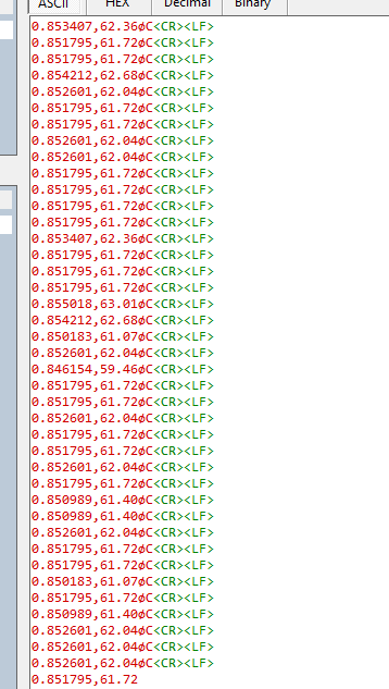

/*I want to read stm32 temperature using ADC1 with timer 2 configured.
I am getting temperature reading as 60 degrees when I configured
ADC1->SQR3=16;
and -275 degrees when ADC1->SQR3=18; Is any thing wrong? */

2019-11-11 10:31 AM
What do we see on the first picture?

2019-11-11 6:01 PM
Yes. Waiting till ADC data arrives.
2019-11-11 6:03 PM
First screen shot is when I configured for channel 16, and second screen shot is the output of channel 18. But in the reference manual it is given temperature sensor is connected to channel 16 or channel 18.
As per the room temperature it should be less than 30 degrees
2019-11-11 6:05 PM
I am using STM32F407 discovery board. Is 60 degrees valid? How to know its correctness?
2019-11-12 7:45 AM
My reference manual says output offsets of up to 45 degrees C are possible due to chip variations.
The data sheet provides the memory location of chip temperature sensor calibration values at two temperatures. Try reading the cal values to get a more accurate slope and offset.
