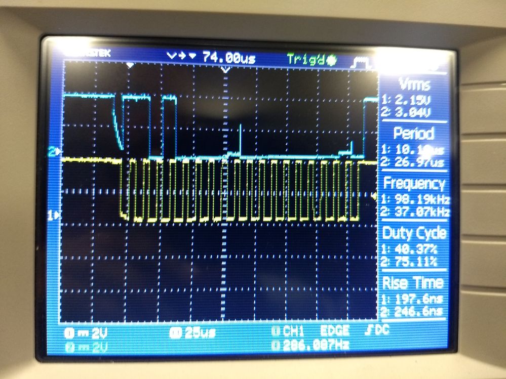

}From the above image you can see that the pulses seems to be chopped.
The first set on SDA defines the slave read address, 11010001, the last bit 1 is not proper. What could be the reason?

Pins used for I2C don't need the internal pullups/pulldowns enabled. Those little spikes you're seeing are when the SDA is released following the ACK clock interval. They don't normally indicate a problem.
What's shown on the scope trace is an I2C write (SDA at the rising edge of the 8th SCL is a 0). This is from line 40 in your code.
