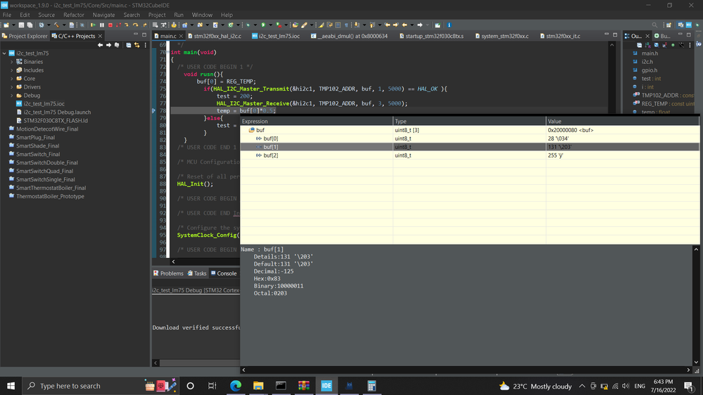

Yes, it will return HAL_OK and put stuff in buf array. like i said i can communicate between device and stm32. this is buf array after i add a break point .(i changed size of array to 3 to test so don't pay attention to buf[2] in screenshots.

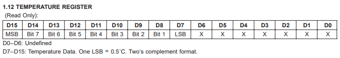

IIRC the 16-bit value is returned in big endian order. So buf[0] is D15-D7
