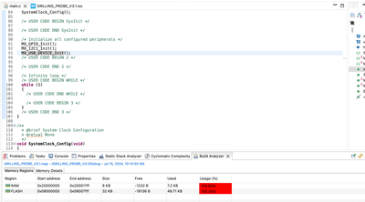

I am using a STM32F070F6P6 microcontroller for a very basic/simple project to help learn the STM32 platform, etc.
I am getting an error when I attempt to build my project that my code overflows FLASH memory by quite a bit. I did a test on a new project, and even without any personal code of my own, if I try to compile the exact same build, the USB middleware overflows my FLASH memory by a ton. I am only using I2C and USB peripheral in my project.
Does this seem abnormal? Am I doing something wrong? It doesn't seem right to me that these add-ins themselves should be enough to overflow the FLASH memory size when I haven't even written a single line of code.
Are there any steps you usually take to optimize the code?

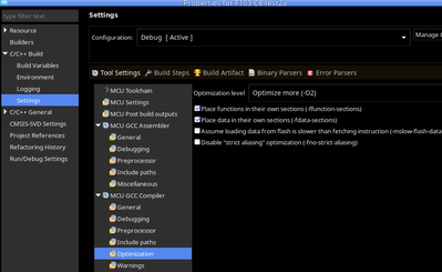

2024-07-15 7:47 AM - edited 2024-07-15 7:50 AM
try : set optimizer -O2 , in IDE -> project-> properties
see:
For F103 with USB->CDC device i get 23KB flash used.
btw just a 32KB cpu is NOT clever decision for anything like USB ...
