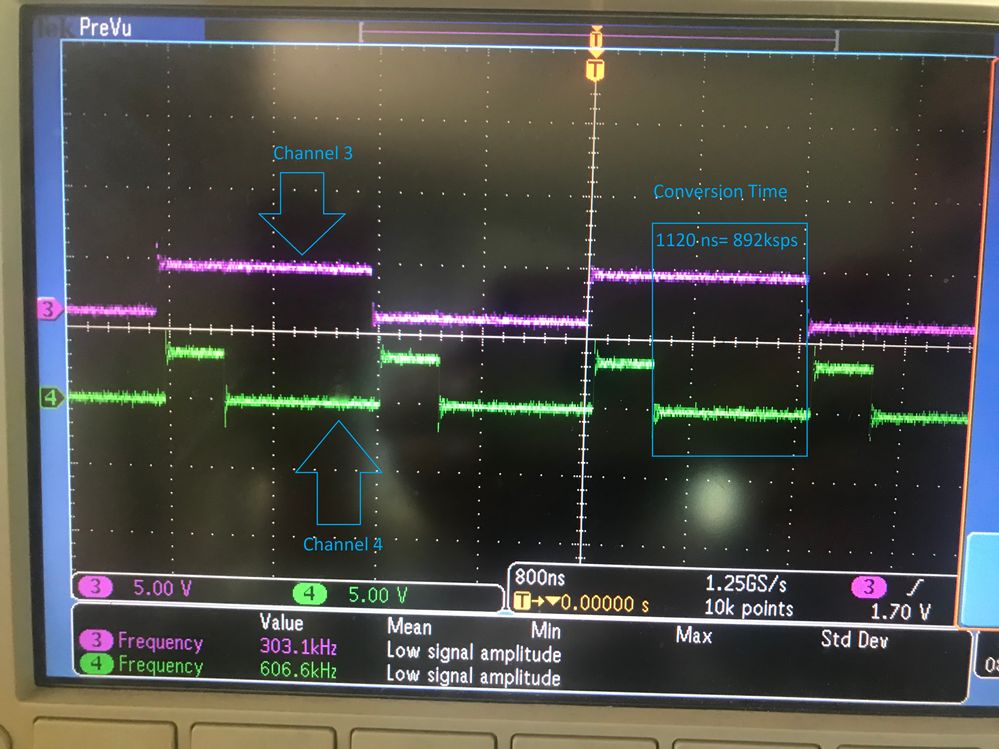

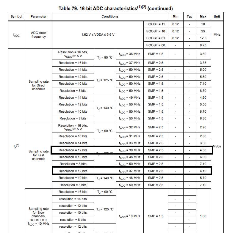

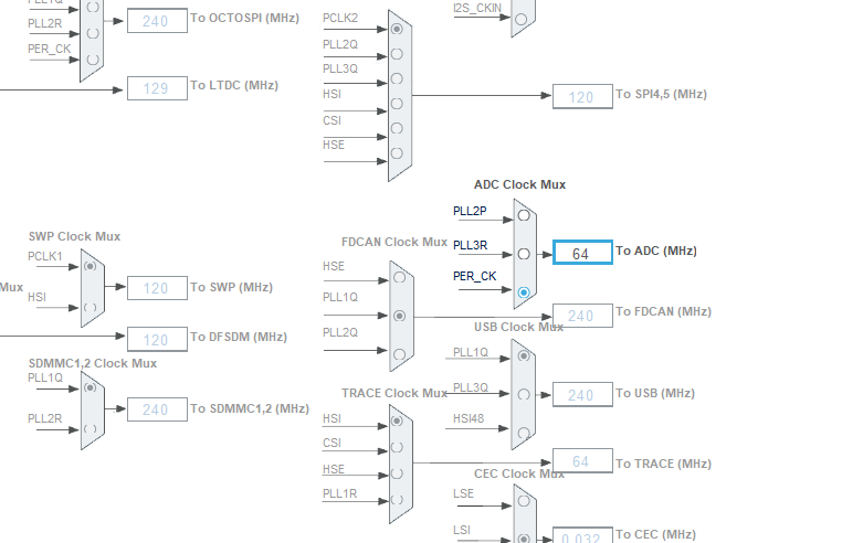

I m trying measure adc conversion time , I look datasheet , f_adc=37 Mhz(for fast channel)
with 12 bit resulation, 4.10 MSps , so ı use f_adc=32 Mhz(for fast channel) with 12 bit resulation, 3.54 MSps should be, but I m not measure 3.54 MSps,I measure 892 Ksps My measurement is as follows, when entering dma interrupt ,I toggle pin , then I set another pin At the end of the interrupt, I reset the pin again. the difference between the two times gives the adc conversion time.where is my fault project file and oscilloscope images are attached.

You can't interrupt at the MHz rates, so instead of doing ONE sample, sample 10 or 100 and decimate the time to understand the sample rate. Use ping-pong buffers with the DMA HT/TC so you aren't working on active/changing data. Watch/manage cache coherency.
2021-12-01 6:53 AM
You cannot effectively measure the time for a single conversion. As I said in the other post you found, time 10000 conversions to reduce the overhead.

Well you'll saturate the MCU with a lot of context switching and all the burden you're carrying with the handlers, the HAL, and the callbacks.
The ceiling here is probably a lot lower than you think it is, and it scales very badly.
