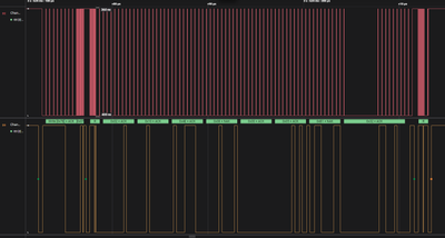

Below is a sample of the logic analyzer capture after the first button press (the DAA process)

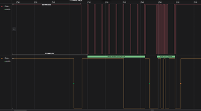

Below is a sample of the logic analyzer capture after the second button press
As you can see, the write sequence after the second button press is "rejected" as the target doesn't ACK the address
Any thoughts ?
