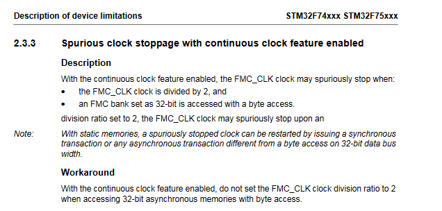

I checked the errata for that chip and found this.
This sounds like the issue I'm having..... I suppose I'll not divide by 2?
Is there a way to manually start the FMC_CLK? or is it dependent on a transaction.

> after 2 read cycles, the FMC stops attempting to read the ‘sram’
How exactly do you perform those "more than 2 read cycles"? Post code and related LA waveforms.
The erratum talks about "continuous clock". Do you have such feature enabled?

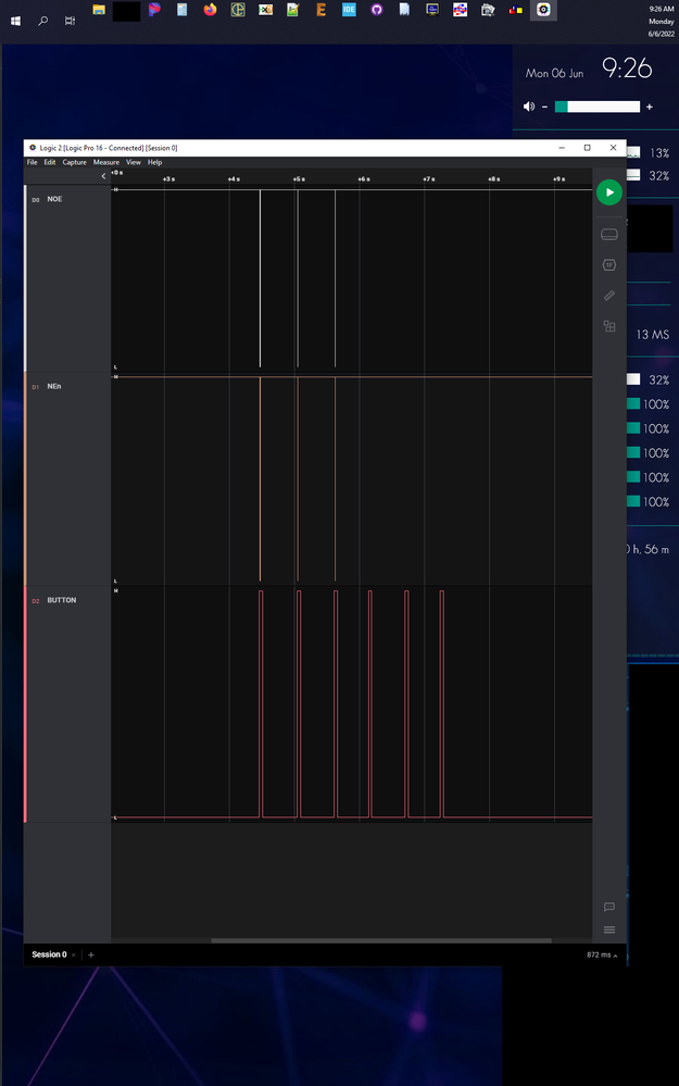

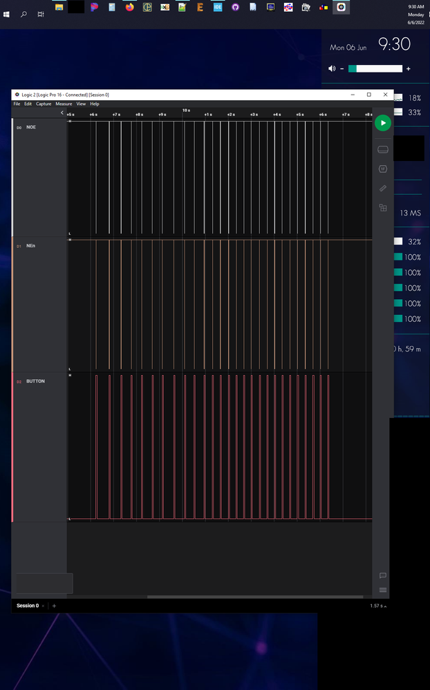

2022-06-06 6:40 AM

You can/should selectively disable caching for the SRAM area in MPU. In fact you should set it as Device.
