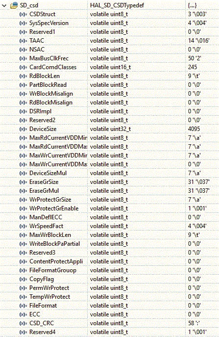

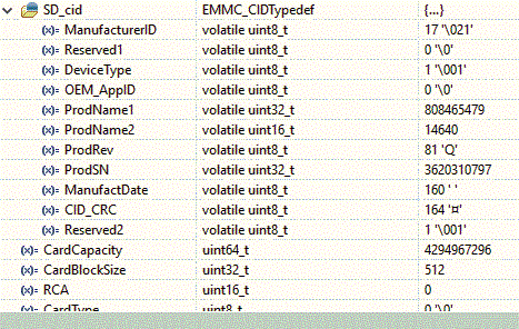

clive1, thanks for your input.
This is the card info I get from eMMC:const int8_t STORAGE_Inquirydata_FS[] = {
