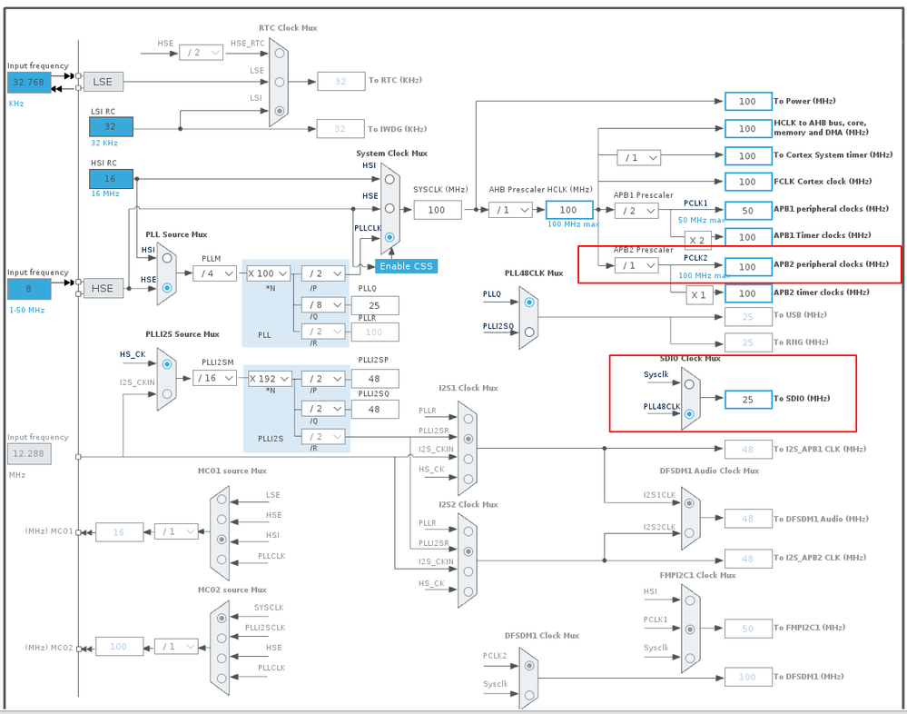

I had gone through the reference manual RM0402 rev 6 , which says the FIFO runs over PCLK2 and PLCK2 should abide,
PCLK2 > ((3*Width) /32) * SDIO_CK
i.e.
100MHz > (3*4/32)*25MHz
I had called `SDIO_Init` with SDIO_INIT_CLK_DIV = ((uint8_t)0x76 while doing initialisation and again for data operations as well (What I meant here is, even though SDIO clock in clock config is 25MHz, I am using very small clock to do init and later operations).
