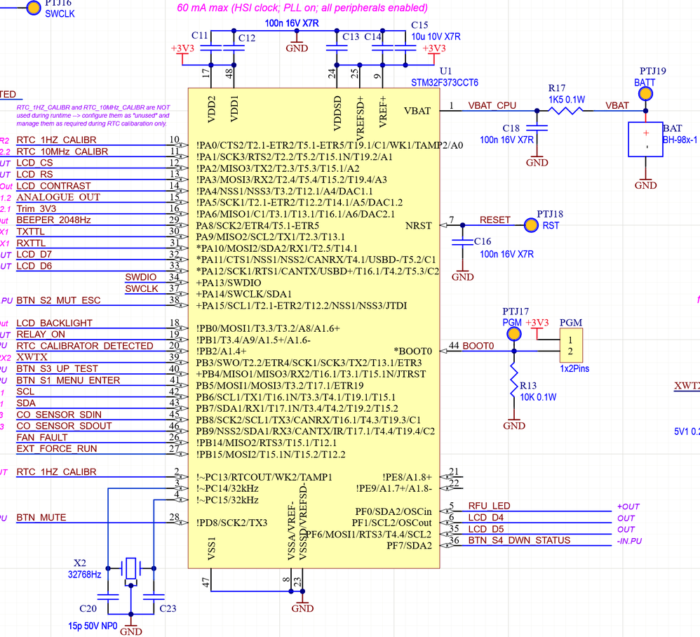

Here's the relevant section of the schematic. The battery is currently sitting at 3.13V.

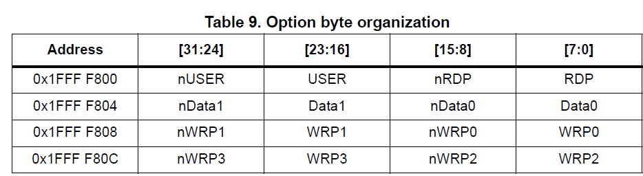

OBR is actually the Option Byte register at address 0x1FFFF800, as described in Section 4 of the reference manual. It's written 16 bits at a time, but the CPU automatically fills in the inverted side. This is, apparently, how you program the FLASH_OBR, because a reset fills in FLASH_OBR from the Option Byte Register.

If I load - for example "e4" into Data0 and "03" into Data1 without changing nData0 or nData1, I've watched the memory area get loaded with "e4" in Data0 and "1B" into nData0, then "03" into Data1 and "FC" into nData1. It seems the "n" fields are read-only.

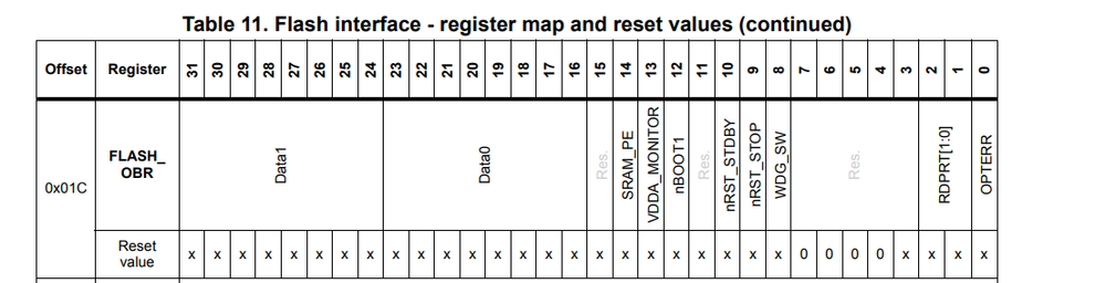

I have (once) seen the OBR start up showing the correct values, but FLASH_OBR is incorrect.
