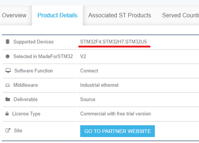

I think our partner PortAutomation offers that stack: see that link https://www.st.com/en/partner-products-and-services/port-ethernet-ip.html
So you need to contact them over this link: https://www.port.de/en/contact.html
Supported devices: STM32F4/STM32FH7/STM32FU5
