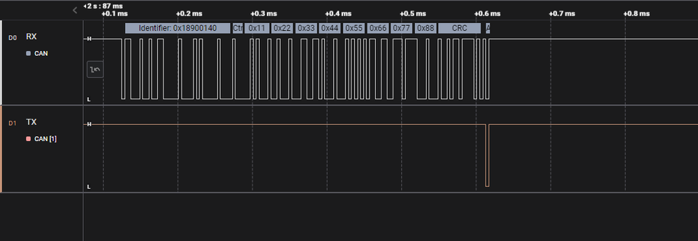

I also checked it with logic analyzer. Transmitter sending the data but the receiver side is not receiving it. This happens only when i use extended ID.

I am not using any external clock. I am also attaching the transmitter side and receiver side code snippets and also the logic analyzer data.

}I have connected logic analyzer on Receiver side and it shows the data on RX pin but Receiver FIFO is empty.
