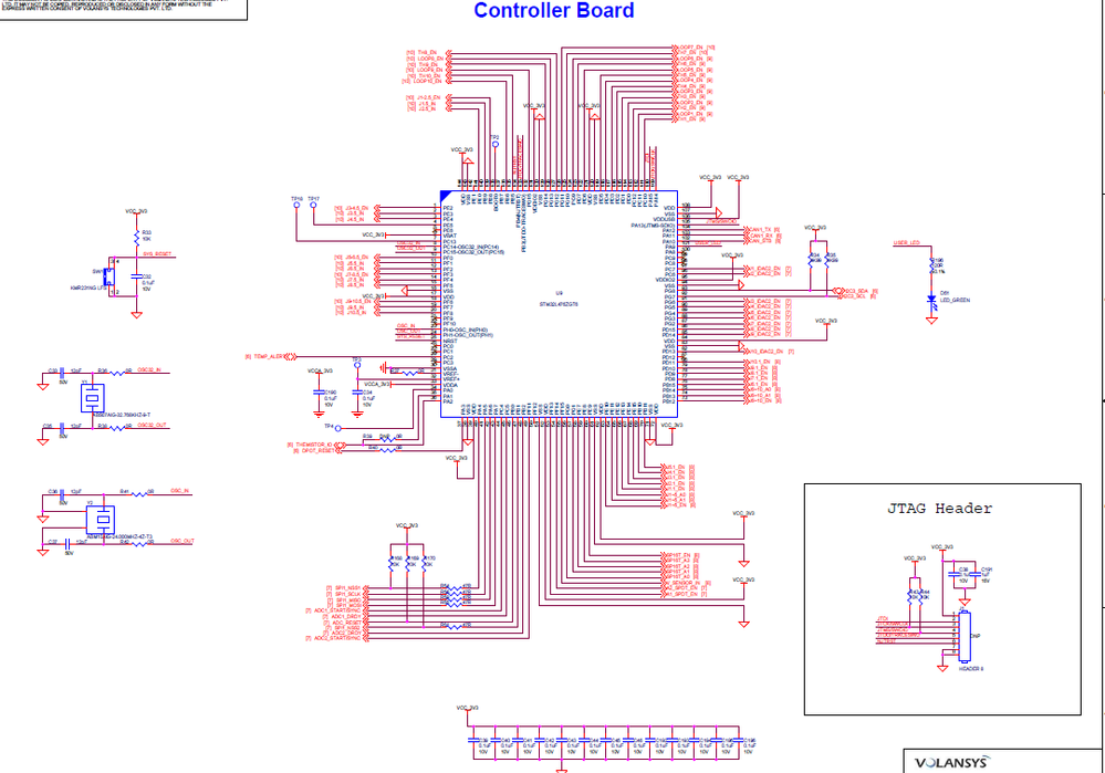

I am using the STM32L476 series controller in one of my projects. It is working as expected for all interfaces connected. But we are facing an issue of self-boot here.
We have observed following things during debugging:
For your reference, I have attached its schematic.

2018-01-01 10:08 PM
Hi Clive,
Kindly find below image of Schematic...
Kindly note that I have externally connected GND through 10K resistor with BOOT0 pin for boot mode setup.

Hi All,
Resolved issue by externally putting high value capacitor (10uF) on NRST pin.
Thank you Clive & TJ for your kind help.
While doing debugging as you suggested, we found that delay is not sufficient between VCC & PoR. So to increase delay added high value capacitor on NRST.
Thanks,
