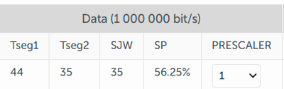

How did you calculate your table of values?
With Tx delay compensation enabled, try these values
2025-09-10 11:56 PM
Hello these bit timings were calculated to get a sample point of 80% and to be consistent over all possible configurations. I will give both proposal a try and let you know.
Just for my understanding, is compensation delay changing rules about sampling point? I was learned to always place it as close as possible to 80% but this comes from times without FD.
Thank you
