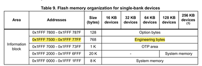

Thank you for a quick answer. STM32G0B1 memory has distinct sections: 128 of option bytes; and 768 of engineering bytes. Only interested in learning how the engineering bytes programming.
Are you saying that both sections share same programming procedure?

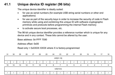

Ahh, my mistake.
The "engineering bytes" section isn't available for you to program.
It holds information like the flash size. Only a few pieces within the region are specified. For example, the unique ID resides within here. You can read out data in here just like any other memory address.
