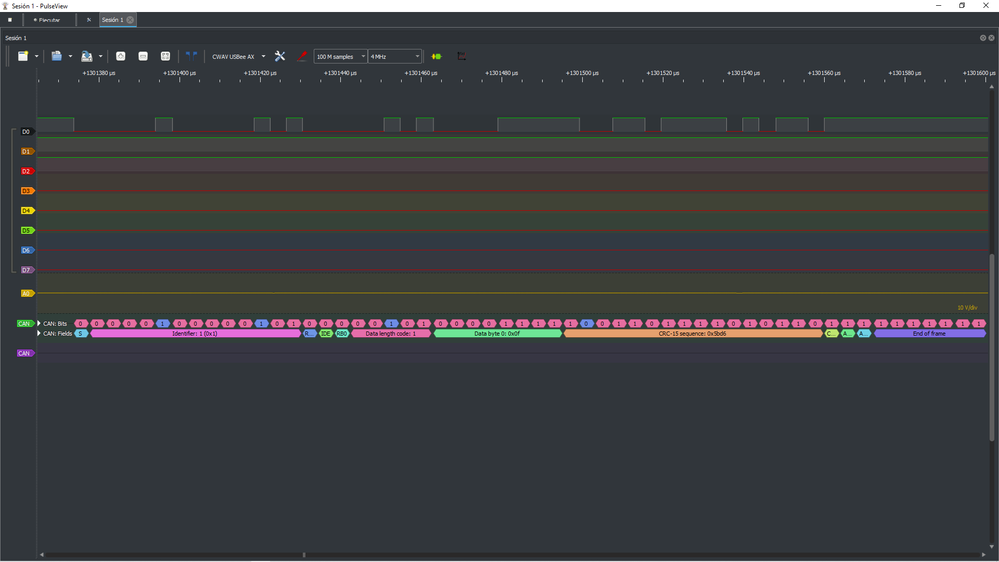

I attach an screencapture of the F407 sending the message in loopback:

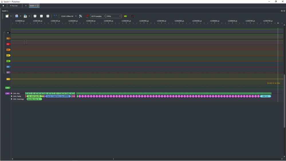

I attach an screencapture of the logic analyzer interface of them sending only the start of frame:

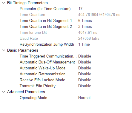

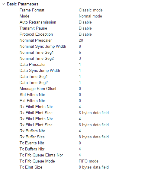

In the H757, the FDCAN is fed by the PLLQ at 42Mhz, with the following config:
In the F407 the can is fed with 42Mhz too, and the following settings:
I would like to achieve between 0.25 and 1 Mbps rates.

2021-04-18 10:10 AM
Please see my calculation parameters CAN for STM32F407 and other STM. I see that You have Nominal Prescaler = 20 for H757 and for F407 You have Prescaler = 17. You must have the same value if You have the same clock, TBS1 and TBS2 (Time Bit Segment).
I do not see You Your filter settings. Please send code from Your program.
