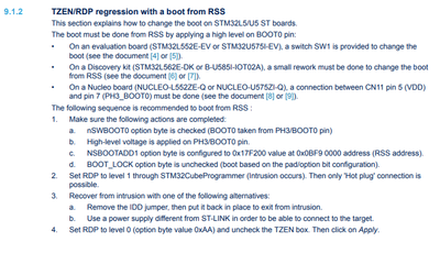

Maybe your board is blocked with RDP level 2 which blocks any debug or System Bootloader access to STM32.
So, try to boot from RSS by applying a high level on BOOT0 pin. For that, I highly recommend you follow "TZEN/RDP regression with a boot from RSS" section in this AN5347 (Arm® TrustZone® features for STM32L5 and STM32U5 Series - Application note)
