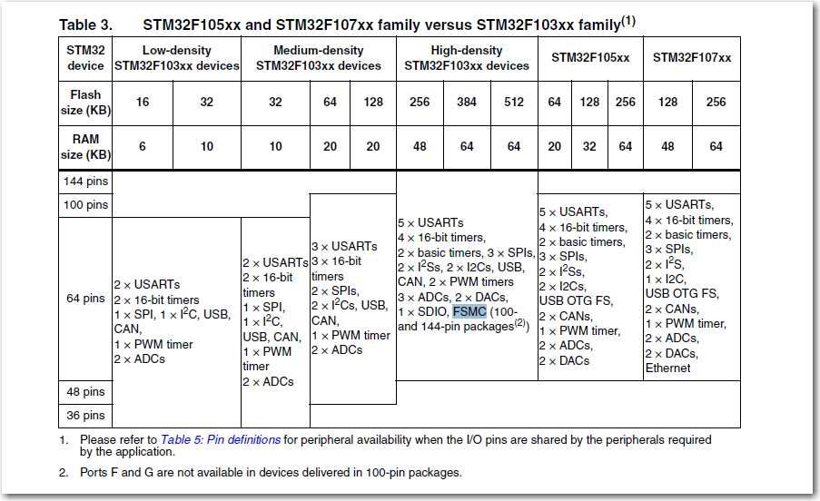

I'm using STM32F107 and NAND flash....
Look I'm not familiar with your design, or the software surrounding it, it's not my project. Does the 107 Connectivity Line even support the FSMC external bus? If you enable the clock bit for the FSMC in the AHB clock register does the bit stay set, or does it remain clear?2014-03-31 2:19 AM
I think this table from datasheet is giving me a clear answer, thanks for the clue clive...
It's working already, thanks for helping, How can I use FatFS with NAND flash ? Nand Flash INIT BEGIN! Nand Flash INIT END! Nand Flash ID = EC,F1,00,95 Type = K9F1G08U0B Written to the number of£º 0 1 2 3 4 5 6 7 8 9 a b c d e f 10 11 12 13 14 15 16 17 18 19 1a 1b 1c 1d 1e 1f 20 21 22 23 24 25 26 27 28 29 2a 2b 2c 2d 2e 2f 30 31 32 33 34 35 36 37 38 39 3a 3b 3c 3d 3e 3f 40 41 42 43 44 45 46 47 48 49 4a 4b 4c 4d 4e 4f 50 51 52 53 54 55 56 57 58 59 5a 5b 5c 5d 5e 5f 60 61 62 63 Read several£º 0 1 2 3 4 5 6 7 8 9 a b c d e f 10 11 12 13 14 15 16 17 18 19 1a 1b 1c 1d 1e 1f 20 21 22 23 24 25 26 27 28 29 2a 2b 2c 2d 2e 2f 30 31 32 33 34 35 36 37 38 39 3a 3b 3c 3d 3e 3f 40 41 42 43 44 45 46 47 48 49 4a 4b 4c 4d 4e 4f 50 51 52 53 54 55 56 57 58 59 5a 5b 5c 5d 5e 5f 60 61 62 63We’re moving the ST Community to a new platform to give you a better and more reliable community experience.
