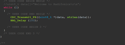

I am using CDC Lib for sending messages.
Please use this button to properly post source code - not as images:
