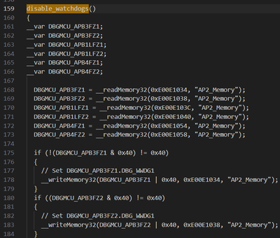

This error occurs right after the 'execUserFlashInit()' macro is called. It then calls a function related to disabling the watchdog. This is what I am seeing in that WD function:
The program faults on either 168 or 169 depending on where the line count starts.
