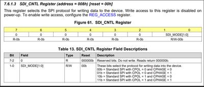

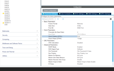

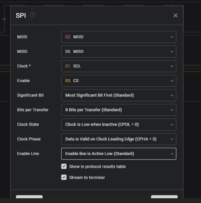

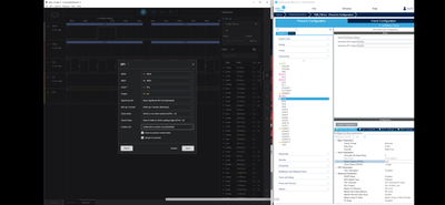

this is my configuration, i think it is correct.
2024-01-23 5:15 AM
One of your configuration is not correct. If you need to read on rising edge, change configuration in MCU (CPHA). If you need to read on falling edge, change configuration in Sealae.
2024-01-23 5:48 AM
Im sure I have the right configuration since the ADC is configured to work as CPOL = 0 and CPHA = 0, like the MCU and the SALEAE (as you can see in the following images).
2024-01-23 8:44 AM
Take a look at your trace from Sealae. You will see that data is set at rising edge and stable (to read) at falling edge. That corresponds to CPOL=0,CPHA=1. If you need CPOL=0, CPHA=0 (reading at rising edge), then you have to reconfigure MCU, because now it is obviously wrong. Don't trust too much to CubeMX... who knows what "1 edge" means ... does it mean "set data on 1st edge" or "read data on 1st edge" ? ;) Take a look at SPI->CFG2 on bits CPOL and CPHA if both are 0. I bet they are not and you simply misunderstood CubeMX naming ... because it is not clear.
