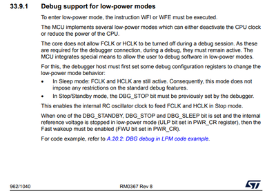

See section 33.9.1 in the Reference Manual:

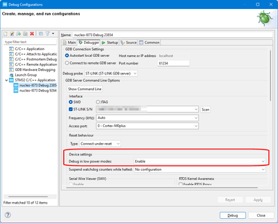

Also, if you're using STM32CubeIDE, enable debug in low-power:
And make sure that your application doesn't disable the SWD pins during sleep ...
