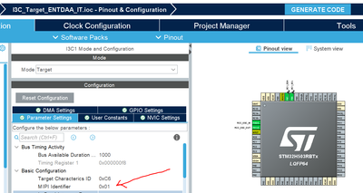

2) I've never used I3C before but I noticed there is something about Dynamic Address Assignment. I've read only a few documents, but it seems that to use this feature I still need to set a different Provisioned ID beforehand (therefore, making it a different firmware). However, I noticed something in the CubeIDE code generator, which shows something about a hardcoded ID (picture below). I don't know what it actually means, maybe it is a GUID that comes hardcoded for each chip or something, maybe not... The point is: can I use I3C to assign an address for each of the Child board, which all have the same hardware and firmware ?

Hello @mpires ,
For I3C , yes you can assign a dynamic address for each I3C target ( STM32H503 in your case ) .
Just you need to check the available examples in the STM32H5 cube FW :
I3C Controller ( Mother board as you say ) : STM32Cube_FW_H5_V1.2.0\Projects\NUCLEO-H503RB\Examples\I3C\I3C_Controller_ENTDAA_IT
I3C Target : STM32Cube_FW_H5_V1.2.0\Projects\NUCLEO-H503RB\Examples\I3C\I3C_Target_ENTDAA_IT
On the target side, you just need to modify this field :0x1 ( target 1 ) , 0x2 ( target 2 ) , 0x3 ( target 3 ) and 0x4 (target 4)
Also for the controller you need to add other files for target 3 and target 4.
For more information , check the I3C AN :st.com/resource/en/application_note/an5879-introduction-to-i3c-for-stm32h5-series-mcu-stmicroelectronics.pdf
and the I3C Wiki : Getting started with I3C - stm32mcu
Let me know , if this helps you!
Foued

Thanks for the fast reply!
Would this mean I would have to have 4 different firmwares too, since I am generating a new code for each one (MIPI Identifier) ?
2024-05-08 2:56 AM
You need to have a firmware for each I3C target and each target need to have a MIPI identifier.
