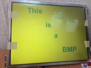

STemWin(''Hello, world'' etc... basical drawing functions from 2D graphical library...)After that I made a simple 1024x768 BMP picture in GIMP (Green text ''This is a BMP'' on the yellow background), then I optimized it using Bitmap Converter, then converted it to C-array using Bin2C for GUI_BMP_Draw() function and finally got it on the screen:

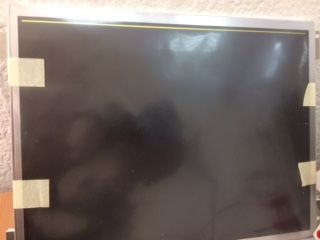

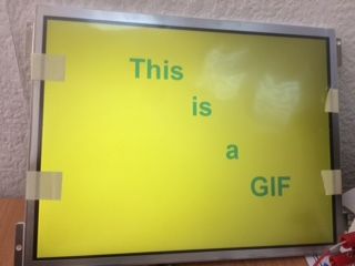

Next I made a same GIF picture (''This is a GIF''), unoptimized it as described in emWin manual (exactly in emWin
UM03001, not in StemWin manualStemWin532.pdf) then again used Bitmap Converter and converted the GIF to C-array for using withGUI_GIF_Draw().And got this one:
Seems that only few first lines of the GIF displayed.
GUI_GIF_Draw()returned 1. That is error.
Next in function
GUI_X_Config()I reconfiguredaMemorylocation to its default address in internal RAM.static U32 aMemory[GUI_NUMBYTES / 4]; // __attribute__ ... deleted. Watch window shows 0x20001308 address.Had to reduce the size of aMemory to
300 KBas internal RAM is only512 KBon the chip:#define GUI_NUMBYTES(300 * 1024)...Frame buffer location for layer 0 remains unchanged:
#define LCD_LAYER0_FRAME_BUFFER 0xC0400000 //in SDRAMC-array containing GIF data also remains unchanged. The only change is
aMemory relocation from SDRAM to internal RAM.And got it:GUI_GIF_Draw()
returned 0. Works fine.

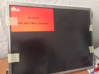

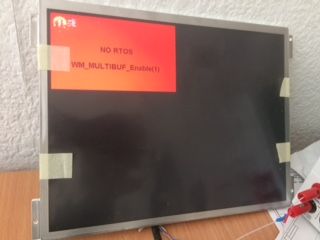

2018-05-29 12:27 AM
WM_MULTIBUF_Enable(0):
WM_MULTIBUF_Enable(1):
The same behaviours. The wings are shown and animated in both cases. And also there is my problem with a bad GIF drawing.
